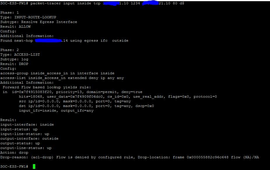

do this packet-tracer let see how traffic NAT and filter
do this before and after add the ACL inbound.
packet-tracer input inside tcp x.x.x.x 1234 y.y.y.y 80 detail
fmacias.duarte
Hi, before the adding the ACL inbound the packet tracer stops at phase:3 ACCESS-LIST (implicit rule). After adding the inbound ACL it goes all the way through. See attachments Before the ACLBefore the ACLAfter ACLAfter ACLESSFW VPN Output6.JPGESSFW VPN Output7.JPGESSFW VPN Output8.JPGESSFW VPN Output9.JPG
Type: ACCESS-LIST
Subtype:
Result: DROP
Config:
Implicit Rule <--
Additional Information:
 Forward Flow based lookup yields rule:
 in  id=0xbc057320, priority=11, domain=permit, deny=true
	hits=8, user_data=0x5, cs_id=0x0, flags=0x0, protocol=0
	src ip/id=0.0.0.0, mask=0.0.0.0, port=0
	dst ip/id=0.0.0.0, mask=0.0.0.0, port=0, dscp=0x0
	input_ifc=inside, output_ifc=any
Type: ACCESS-LIST
Subtype: log
Result: DROP
Config:
access-group NAME in interface inside <--
access-list NAME extended deny ip any any <--
 in  id=0xbb9ba040, priority=13, domain=permit, deny=true
	hits=0, user_data=0xb94669e0, cs_id=0x0, use_real_addr, flags=0x0, protocol=0
 they seem a same but there are different the traffic is drop by config ACL not by implicit Rule (I attach two different drop by two different ACL types)

You are right, is not the implicit rule the one that is denying the traffic, it is a configured any any ip deny rule at the end. I only have four different ACLs:
