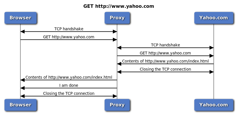

This is like what happens in the HTTPS Proxy,
There are 2 separate Https sessions :
1- Client to F/W ( or https Proxy )
2- Firewall to Webserver
In this case the F/W act as the Google Web Server and reply to you with Google IP.
On the other hand it will send the request to the Webserver acting as it is the real client.
Since the traffic is HTTPS, your browser need to trust the Certificate generated by your firewall which is acting as the real Google Certificate in your case.

In proxy case, traffic directly go to proxy (IP configured in browser). Even DNS resolution also does done by proxy. That means client nothing know about server information and proxy does everything on behalf of client. In that case it is clear to me that client only know about proxy IP and it create TCP+SSL with proxy only.
But when traffic follow routes and pass through firewall with NAT, that time client direct establish TCP+SSL with server. Query is here that if TCP+SSL establish directly between client server then how firewall certificate come in between.
I checked on wireshark also. TCP and SSL does happen between client IP and server IP but certificate come in browser from firewall.

what you say is 100% correct in Explicit Proxy mode, in Transparent Proxy the Client have no idea there is a Proxy server in the network.
in both cases, if SSL inspection OR https Decryption is enabled, Proxy server act as Man In The Middle.
you can try to capture packets from Firewall, you will see
Client  ----- TCP.stream 1  ---> Firewall ---- TCP.Stream 2 ---> Google
so there will be 2 separate sessions there.
