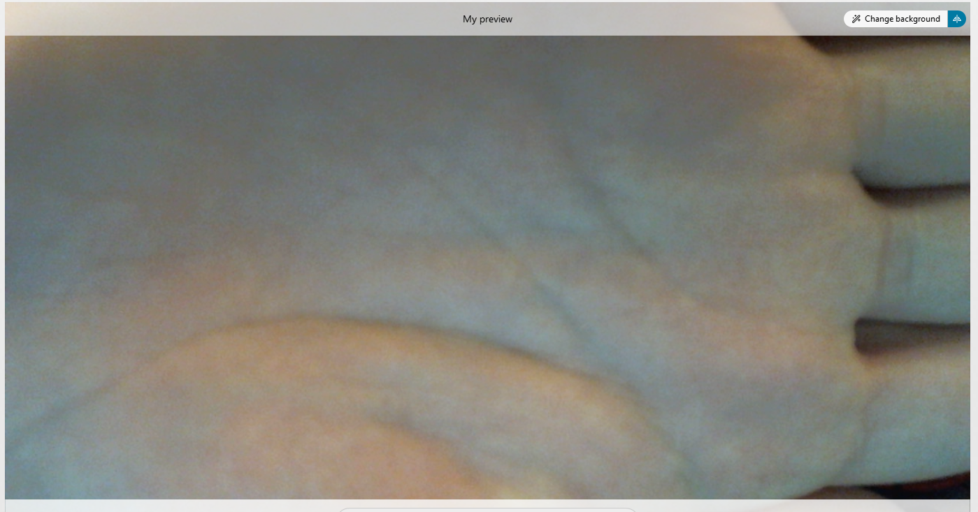

I'm having a problem with the video portion of a meeting. The attached image shows the issue -- four small rectangles and otherwise a blank screen. It seems that it's only on my end -- participants see me normally. If I select to show myself in mirror view, then my video of myself is fine (also attached), but I still see others in the meeting as shown in the attached image, four thin rectangles rather than a usable image. I've had them try flipping their mirror image toggle and it doesn't help on my end. One time I resized the window and it made them appear normally, but then when I adjusted the window size again it went back to the rectangles and I haven't had it normal again since.

Yes! Thank you. I had adjusted the nvidia 3D image setting to quality over performance and I forgot! When I simply set it back to "Let the 3D application decide" it works on my end without mirroring, so I assume that it will show participants as well.
