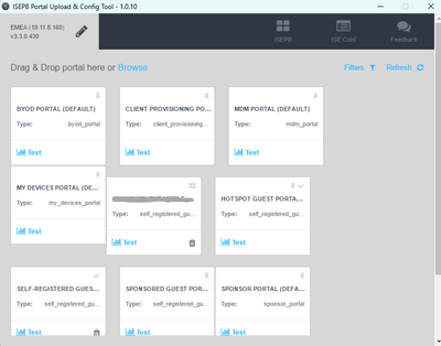

Got an issue with the ISE portal builder (https://isepb.cisco.com/#), built a new portal followed the documentation (e.g. downloaded the config/uploader tool) but this tool is not working correctly??.. Filled in the required criteria but apparently ISE is resetting the connection/tool??.. Using an admin (SuperAdmin) account and confirmed access to ISE using a browser.
ISE v3.1 - ISEPB Portal Upload & Config Tool v1.0.10

Anyone seen errors like this and have a workaround??.. Tried internal and external accounts, the documentation for this tool is virtually non-existent. Not sure what the AD setting at the bottom is for, by default it populates with "Internal" so assume a local admin account is required which I have tried so many times.

See what I've seen in the Audit Logs for the Admin access:
And disabling the "Pre-login banner" has made the trick and now I have access:
And enable login back again after the portal is uploaded.

The only way to do it is by downloading the portal .TAR file, using the ISEPB Tool, Connect to your ISE deployment and upload the portal file.
