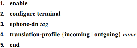

配置Translation Rule
章节: Defining Voice Translation Rules inCisco CME 3.2 and Later Versions
应用translation Rule到SCCP话机
章节: SCCP: Applying Voice Translation Rulesin Cisco CME 3.2 and Later Versions
章节: SCCP: Applying Translation Rules BeforeCisco CME 3.2
应用translation Rule到SIP话机
章节: SIP: Applying Voice Translation Rules inCisco Unified CME 4.1 and Later
章节: SIP: Applying Voice Translation Rulesbefore Cisco Unified CME 4.1
检查translationrule
Showvoice translation-profile
Showvoice translation-rule
Testvoice translation-rule number
