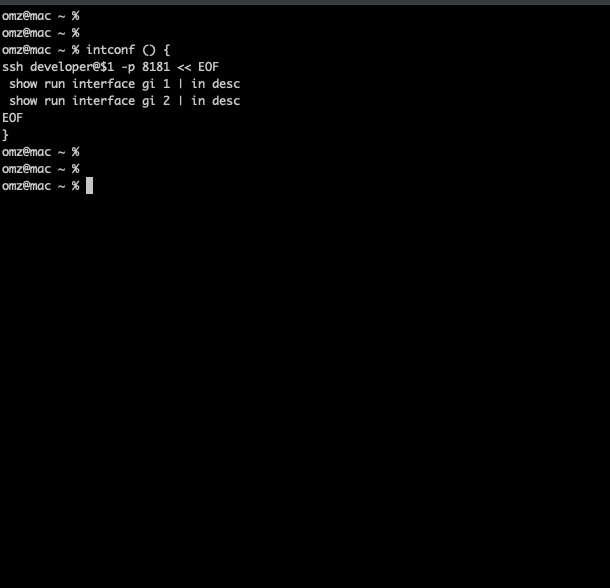

omz
Hi
Are you using shell to ssh to the apic?
You could something like this -
copy and paste in shell
intconf () {
ssh root@$1  << EOF
 show run leaf 109 interface ethernet 1/23
 show run leaf 110 interface ethernet 1/23
EOF
I don't have ssh access to an apic. Example on IOS-XE works like this -
you can add the function in .bashrc and it will available everytime you open terminal
hope this helps
