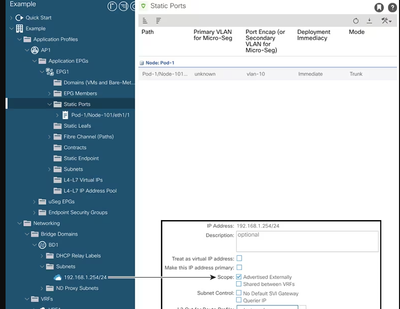

It can be a variety of things really, without going into much detail check if those BDs have the checked Advertised Externally, Check the guide here https://www.cisco.com/c/en/us/td/docs/switches/datacenter/aci/apic/example-files/l3out-configuration-examples/l3out-configuration-examples/m-ospf-l3out-with-two-external-routers.html
