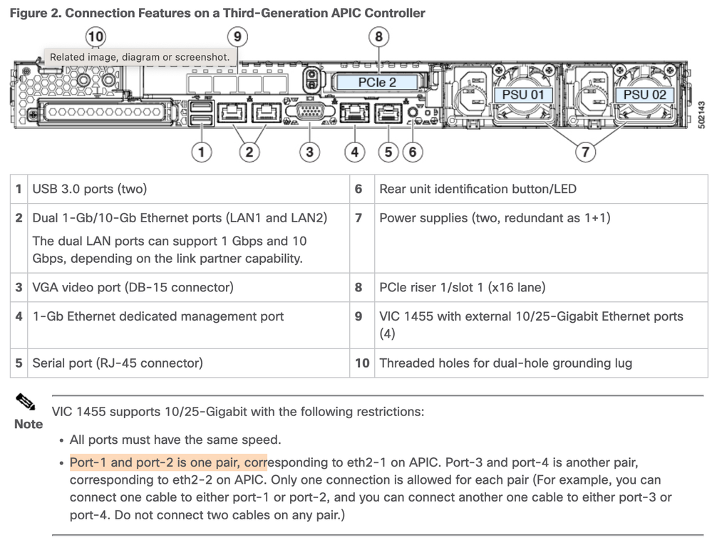

I finally found the problem.
I had 4 connections between APIC3&1 and the leafs instead of 2.
VIC 1455 is used on the APICs. All  4-ports on this NIC were cabled to the Leaf.image007.pngimage006.png
after shut 2 ports it worked!
