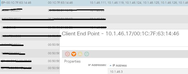

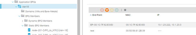

Going a little bit deeper in your explanation, I tried to check MAC address learned on ACI and found the two MAC addresses of the two GWs as learned, and not associated with the VPC MAC address.
10.1.46.3 Vlan 46:
10.1.23.3 Vlan18:
Honestly I don't understand why mac address learnt in ACI of both gateways are of external switch side portchannel's mac.
Probably I'm wrong, the GW MAC addresses arrive at the ACI via the same VPC link, but this doesn't mean that their MAC address will be the VPC link MAC. VPC is simple L2, so there are no encaps or decaps for MAC address.
