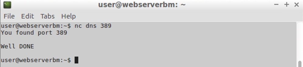

I built my lab like this
As I said, I don't have AD servers, but I do have a DNS server, and I ran netcat on the DNS server to listen on port 389 as a test, and on port 88 (and 389) on the AppServerBM, and the WebServerBM was already listening on port 80.
From the AppServerBM, I could hit port 389 on the DNS - and the name dns  was also resolved (testing UDP port 53)
Same story from the WebServerBM
And from the DNS itself, a test on some ports in the reverse direction (simulating Domain Controller contacting AD Server). I used a different message here and a simpler command - on the AppServerBM I ran
echo "Welcome to port 88, normally Kerberos authentication" | sudo nc -l 88 and later
echo "Welcome to port 389, normally LDAP" | sudo nc -l 389
And finally, from the DNS, a test of the webserver.
Conclusion
I was able to create a contract that worked for the purpose of allowing AD communication initiated either by an AD server or a Domain Controller
The contract subject was configured with the Apply Both Directions option set, but without the Reverse Filter Ports option.  Essentially, I manually created the reverse filter ports by configuring a filter that included the target port numbers in two filters each (one as Source Port, one as Destination Port) per protocol (TCP and UDP).
Although not an exhaustive testing, I think the model above will do what you want. If you actually test it out, please let us know on the forum how it went.  If I get some positive responses, I'll write this up as a blog post.
