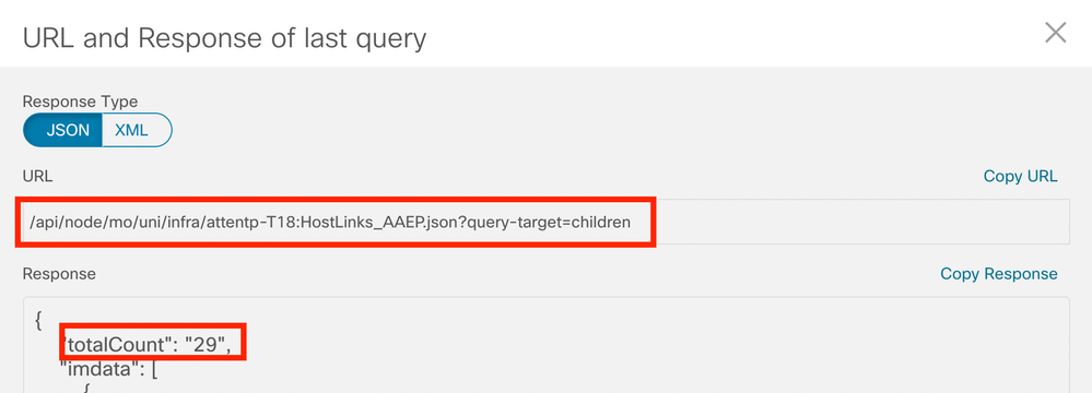

Secondly, I know you can have multiple Physical Domains associated with an AAEP, but I'm not sure if there is a limit, but for fun, I just added 29 Physical Domains to an AAEP (using the GUI) and did not get an error. I even made sure that two of these domains had overlapping VLAN pools.
