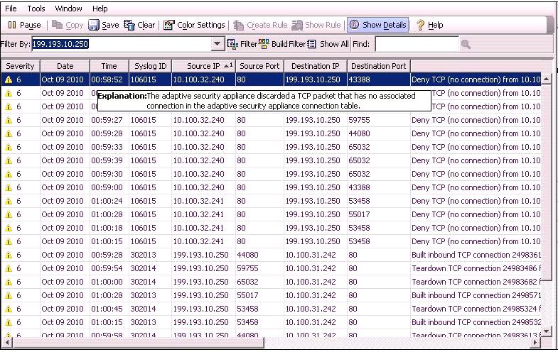

I have a very strange issue going on. I have a CSS setup with a two-armed config. The services live on the private interface of the CSS and the VIPs live on the public interface of the CSS. I am balancing the VIP 10.100.31.242 amongst three services (see config below). I am having trouble with services ws07_13 and ws08_13 which I have since suspended. Service ws06_13 is working fine. The behavior I see with ws07_13 and ws08_13 is very odd. When the are active and get sent a request by rule-242 they reply with thier own IP to the upstream firewall (cisco ASA). In turn the connection on the firewall get dropped. According to the cisco ASA logs the service IP (10.100.32.x) is trying to reply to the actual Internet IP. I have provided a screen shot of these logs via the ASDM below. You will see where services ws07_13 (10.100.32.141) and ws08_13 (10.100.32.240) are trying to reply to Internet IP 199.193.10.250 which gets dropped by the ASA (deny TCP no connection). I am not seeing this behavior with service ws06_13 (10.100.32.242)
The arp tables on the CSS , switch and upstream firewall (cisco ASA) look OK. I do not manage the servers that these services live on. I just want to rule out networking (I manage the CSS, switches and firewall) before I have the server owner compare the working service (ws06_13) to the non-working services (ws07_13 & ws08_13).
