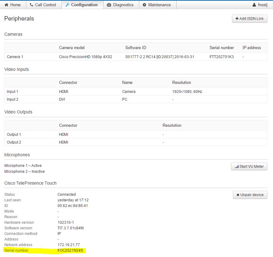

is there a possibility to get the Serial number remotly from a Touch 10 device ?
I have tried to find somthing in the peripherals Settings from the SX20 or SX10 but there is only shown the  Serial number from the camera.

When Touch 10 device is connected to the SX20 you can browse to the video system, and then select the menu Configuration / Peripherals. The serial number appears at the bottom of the page. See examples in the attached file.
