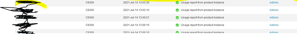

Yes, thats what TAC told us, too. It seems to work from 17.3.3 and CSSM on-prem (8-202105) with CSLU.
! Lookup CSLU URL from "on-prem" Server !!!
! Transport with CSLU method from 17.3.3
! Config
license smart enable
license smart utility
license smart url cslu https://10.X.X.X/cslu/v1/pi/SMART-1
license smart transport cslu
end
! Global
license smart trust idtoken XXX local
license smart sync local
Afterwards devices showed up.
