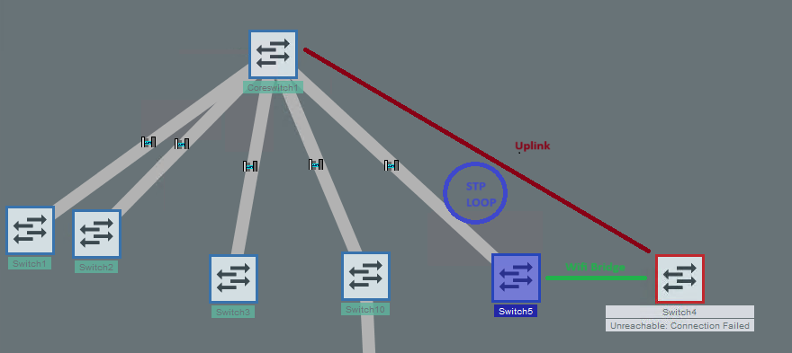

You have wireless brdige?
Can you draw topolgy

trevor.stuart
This shows the topo... it's between switch 5 and 4 that the wireless bridge is in place. I have the uplink port on switch 4 disabled right now so the switch doesn't run out of memory that's why it's not showing them linked and it indicates switch 4 is off. But I can get into switch 4 via the console right now and re-enable the uplink anytime just starts the flapping as soon as I do and will eventually run out of memory.
The only solution I see is making direct link between two SW4 and SW5 with high cost so SW4 and SW5 select the direct link to Core as Root Port.
It issue of STP cost I think
MHM
How would I do that? There is only 1 link between 4 and 5. Currently only 1 uplink port on both for this go-between. If/when I get this solved I'll look into a second port on each end for redundancy but right now just want to get this current issue cleared up.
From what I understand STP does sound most likely, I just don't know what to do so switch 4 "cleans up" whatever is broken when the link returns.
Is below correct ?
MHM
No...The red uplink doesn't exist...
It's an IP link point to point and it's the only link between swtich 4 and the rest of the network.
It's not excatly wifi either, as it's a licensed 15Ghz link but same idea in the end... That bridge is my uplink.
