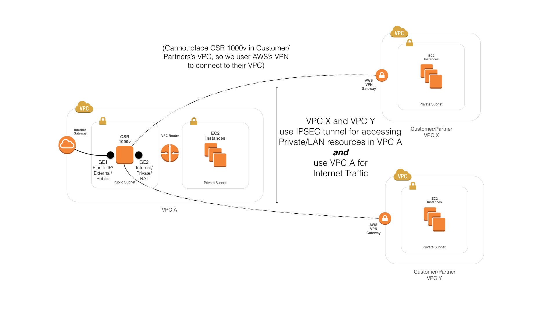

I have a number of customer VPCs with private subnets, which have no internet access that I need to connect to an AWS VPC that I own. By connecting them to my VPC, I need to provide them with:
  • Access to private resources inside of my VPC
  • Transitive access to private resources that are connected via IPSEC VPN to my VPC
  • Provide internet access to them via NAT
Since I do not own the customer VPCs, I cannot always expect to be able to install a 1000v in that environment. So, I am connecting the customer VPCs to my 1000v via AWS's IPSEC VPN Gateway. I was able to successfully connect the customer VPCs to the 1000v via IPSEC tunnel and they are able to access private resources within my VPC. But, I am unable to figure how to provide Internet access to the customer VPCs.
The customer route tables look like the following:
Network  Destination
(local)  Local Route Table
0.0.0.0 VPN Gateway
As stated in this document: http://www.cisco.com/c/en/us/td/docs/routers/csr1000/software/aws/csraws/awsoverview.pdf, "You cannot apply NAT PAT on the same interface that is configured with a crypto map." Does this mean that I am unable to provide internet access via NAT for the VPCs that are routing through my 1000v? How do I get traffic that is coming in from the tunnel and destined for the internet to use the NAT in my VPC? Below you'll find an architectural diagram:
Thanks!

Fan Yang
According to the guide, yes, you can't use PAT/NAT for the IPSEC enabled interface. But it also has some workaround as following.
  • The workaround is to use a different IP Security feature such as SVTI or DMVPN, or you can configure a two-router solution with one router for NAT and another router for the IP Security crypto map
Since AWS VPN Gateway doesn't support GRE tunnel. You can't use SVTI or DMVPN between CSR and VPN Gateway. But you can try with the 2nd workaround by placing two-router in your VPC-A. One router for NAT and another for IPSEC.
Hope this answer your questions.
Thanks
Fan
I've read about the two-router solution. How would that work? Would I make the default route of the crypto 1000V that of the NAT 1000v? Wouldn't that beak the tunnel?
For example, you have two CSR in your VPC, CSR-A(LEFT) and CSR-B(RIGHT). CSR-B is building IPSEC tunnel with your customer's VPC. CSR-A is connecting the IGW in your VPC.
After CSR-B has decrypted the data, CSR-A will do the NAT.
Thanks
Fan

I don't see how this will work seeing as both CSR-A and CSR-B require a route to the Internet Gateway. CSR-B needs a public IP address in order to perform IPSEC and CSR-A needs a public IP to perform NAT. If traffic coming through the tunnel to my CSR-B is destined for the Internet, the IGW Route (0.0.0.0/0) attached to CSR-B will receive this traffic. How can I route traffic that is coming in through CSR-B to CSR-A when a route already exists that directs this traffic to 0.0.0.0/0? If I created a 0.0.0.0/0 route to CSR-A, wouldn't this break the IPSEC tunnel?
