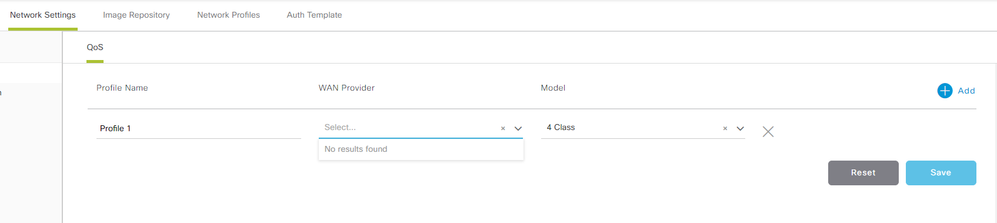

Hi All,
I'm trying to create an SP profile in DNAC but I am unable to select a WAN provider as the drop down options are blank and I cannot add anything. A WAN provider needs to be specified before I can save the profile. Screenshot below. Has anyone seen this before? How do I add a WAN provider?

Sorry I have figured this out. You have to type an entry in the WAN Provider box and then click 'Create option'. This then allows you to save the profile with your manually created entry.
