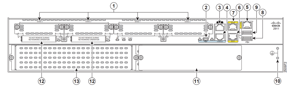

Leo Laohoo
Look at the back of the router and look at the picture below.  Look at #12.
Pop the lid and see if there is a CF inside.
If there is no CF inside, then look at #8 & #9.  They are USB slots and can read USB flash drives.
