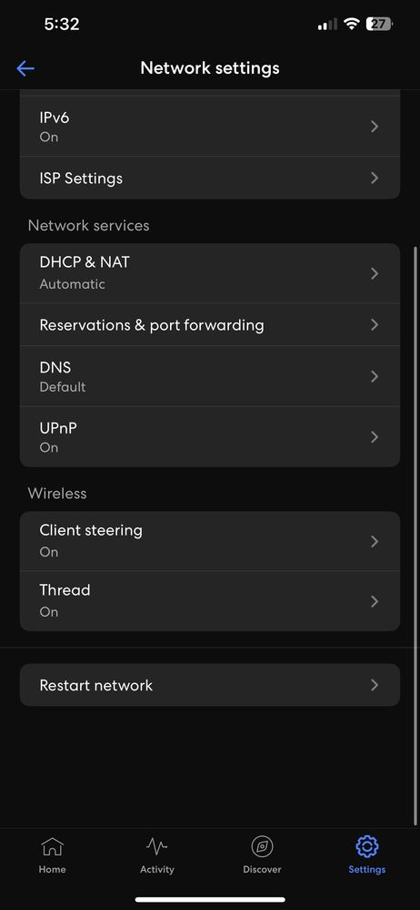

All of the wi-fi networks are running on WPA2 AES which is the current standard.  We already determined that WPA3 is disabled by default in the EERO app. Here are the current EERO app settings for my test user.  They are going to test by turning of IPv6 next.
