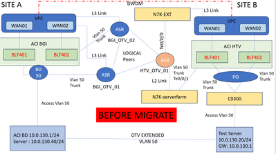

Below is the diagram. The Gateway for site B is sitting in site A BD 50 in the ACI. The intermittent ping only happens when the host in Site B Vlan 50 ping to the BD gateway in Site A. When pinging to host in Site A Vlan 50 there is no ping loss.
I noticed something peculiar, when adding in a L2 HOP (Test Scenario) the intermittency issue is resolved. I cant seem to pinpoint where the issue is, as far as i can see the ACI is forwarding the packet to the correct path which is to the ASR router for the OTV

I meant whether there is a difference between the two "red" links in the layout:
Ohh.. nop they are the same trunk port with mtu 9000

TROUBLESHOOTING STEPS
We took built-in ACI SPAN capture on SITE_B site and see that server 10.0.130.20 keeps sending ICMP requests even when it doesn't receive reply from default gateway. So, it doesn't seem to be ARP resolution issue in SITE_B site.
On BGI Leaf 301 in BGI site we captured packets with tcpdump and see ICMP Requests from 10.0.130.20 received and replied to immediately. However, on same capture, when server 10.0.130.20 starts seeing drops, packet capture 'stops' -- we don't even receive ICMP Requests from 10.0.130.20 during failure periods.
ASR1k team checked the traffic and see the packets getting dropped on ASR1k in SITE_B site when destination MAC 00:22:bd:f8:19:ff, which is the MAC of default gateway 10.0.130.1 and is supposed to be learned from BGI site, is getting learned from SITE_B site.

Here is the output from SITE_B ASR1k that shows destination MAC of default gateway 10.0.130.1 being incorrectly learned from SITE_B site
SITE_B_ASR_OTV1#sh otv route vlan 50
Codes: BD - Bridge-Domain, AD - Admin-Distance,
SI - Service Instance, * - Backup Route
OTV Unicast MAC Routing Table for Overlay1
Inst VLAN BD MAC Address AD Owner Next Hops(s)
0 50 50 0022.bdf8.19ff 40 BD Eng Te0/0/1:SI50 << OTV SITE B INTERFACE to ACI
0 50 50 00fc.ba63.d391 50 ISIS MYSEL_BGI_L3_ASR_OTV1
0 50 50 3429.8f73.256b 40 BD Eng Te0/0/1:SI50
0 50 50 4006.d5aa.475a 40 BD Eng Te0/0/1:SI50
0 50 50 482e.723a.01b6 40 BD Eng Te0/0/1:SI50
0 50 50 482e.724b.9668 40 BD Eng Te0/0/1:SI50
0 50 50 98be.940c.dc50 50 ISIS MYSEL_BGI_L3_ASR_OTV1
0 50 50 b026.28e5.6cdc 50 ISIS MYSEL_BGI_L3_ASR_OTV1
0 50 50 cc16.7ec1.f73c 50 ISIS MYSEL_BGI_L3_ASR_OTV1
0 50 50 e4c7.2200.3245 40 BD Eng Te0/0/1:SI50
10 unicast routes displayed in Overlay1
10 Total Unicast Routes Displayed
SITE_B_ASR_OTV1#
Once the MAC table on ASR1k has 00:22:bd:f8:19:ff pointing to SITE-A site, connectivity restores.

in summery
the root cause was due to both Site A ACI fabric and Site B ACI fabric using the same mac address 0022.bdf8.19ff.
ACI by design is made to use the same mac address accross the fabric but when an external extention of vlan is introduced the mac address is seen on the other end via IGMP and not via broadcast. that is why in the senario when we added in the c9300 the issue went away. it is because the 9300 also has its own igmp enabled by defauly there for becoming a proxy and sending its own mac address to the otv router rather then the ACI one.
i hope this helps anyone who faces such issue in the future.
