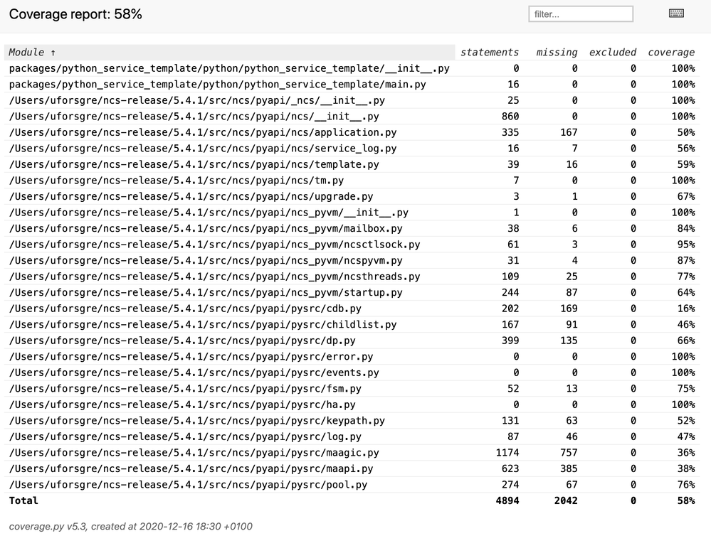

During some other test related work I came across Coverage.py  and it was much easier to use than I thought and can produce HTML reports that gives a very good overview and also details down to each line of code loaded to memory.
Here is one example to how to use it for a simple Python based service. The package name is python_service_template and will be run outside of NSO.

Now you will find a file .coverage in the directory where the service was running. To show a textual overview just run:
coverage report
To produce a more extensive HTML report run:
coverage html
The HTML report end up in a directory htmlcov and the overview looks like this, showing a summary of all used modules. It also has a seach function if you have a lot of files.
