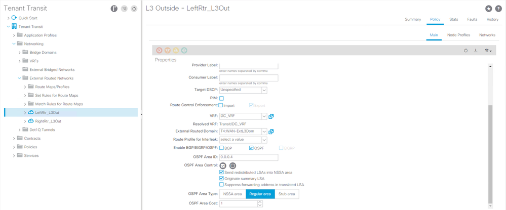

First I created a Tenant called Transit with a VRF called DC_VRF
Then I created the first of the two L3Outs. I called it LeftRtr_L3Out and assigned it regular OSPF area 0.0.0.4 and made sure it was linked to the DC_VRF and the appropriate External Routed Domain that held the interface configuation for Ethernet 1/1 and a VLAN pool with VLAN 2304
I give it a Logical Node profile pointing to leaf 101 and an SVI Interface for VLAN 2304 on Ethernet 1/1 on Leaf 101.  I used an IP address of 192.168.4.2/24 as I already had a router attached with an IP address of 192.168.4.1/24 on its G0/1.2304 sub-interface.

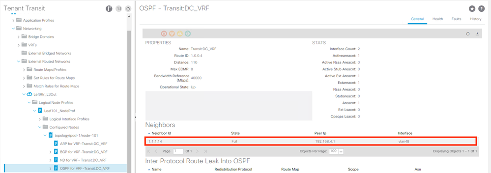

And by now the LeftRouter and Leaf101 have become neighbors:
 And on the router:
LeftRouter#show ip ospf neighbor
Neighbor ID     Pri   State           Dead Time   Address         Interface
1.0.0.4           1   FULL/DR         00:00:38    192.168.4.2     GigabitEthernet0/1.2304
