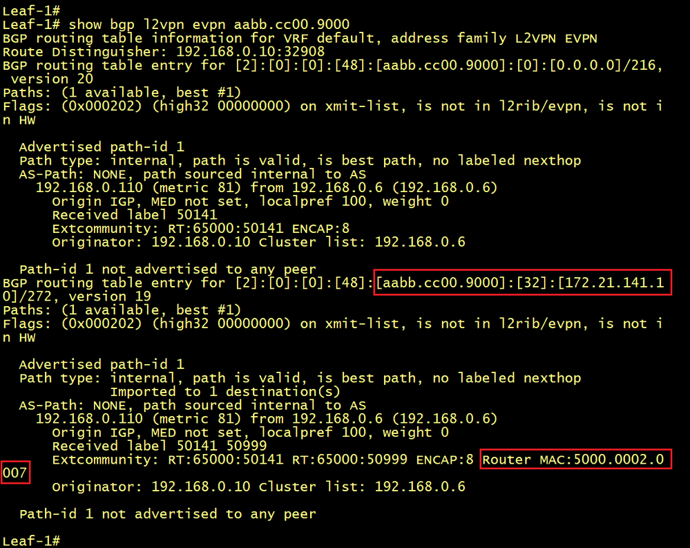

The new inner destination MAC 50:00:00:02:00:07 is the Router MAC of the VTEP next hop Leaf-3 to reach the MAC-IP Route of Host 3 learned through a Route Type 2 BGP Control Plan. The Router MAC of Leaf-3 is learned by Leaf-1 via the Route Type 2 through the Extcommunity BGP Attribute as shown by the sh bgp L2vpn evpn command on Leaf-1.
We can confirm on Leaf with the show NVE interface on Leaf-3.

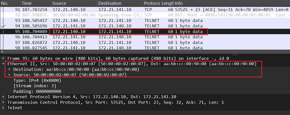

The Leaf-3 Switch removes the VXLAN encapsulation and rewrites the inner L2 Ethernet of the previous VXLAN Packet with a new Source MAC 50:00:00:02:00:07 and new Destination MAC aa:bb:cc:00:90:00.
The source MAC 50:00:00:02:00:07  is the MAC Address of the interface VLAN 141 as shown below.
The Destination MAC aa:bb:cc:00:90:00 is the MAC Address of the Host-3 as shown below.
