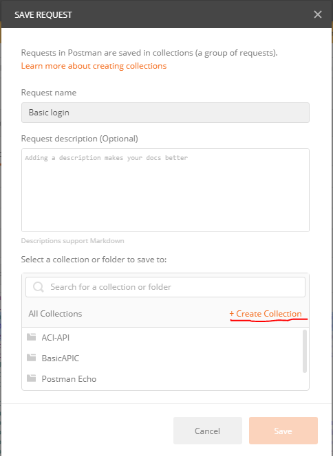

2. Create Collections
On the top left hand side of your postman you can click either one of these button to create a new collections.
You can name it accordingly (e.g. Add Tenant) and click Create
