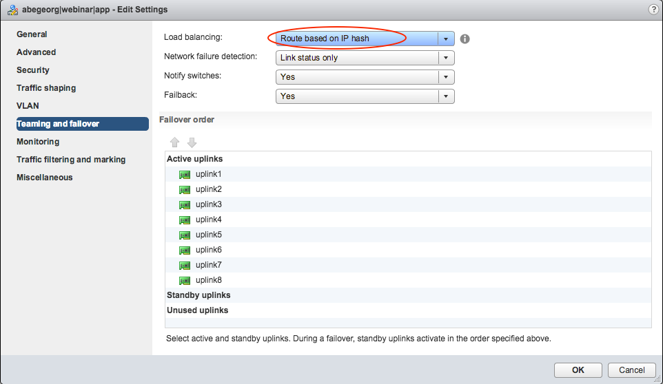

Based on the review so far, we see that the traffic from the VM (10.10.92.1) is load-balanced across both FI-A and FI-B side, which is not supported for UCS-B series chassis deployment. The only supported load balancing mechanism when UCS B series is used is Route Based on Originating Virtual Port, which is expected to either through FI-A or FI-B (not both). So, now lets review the load-balancing policy configured at the DVS.
Review the DVS load-balancing policy at vCenter
LACP is enabled for DVS uplink, which is not expected.
The load-balancing policy for the DVS port-group is configured with "Route based on IP hash", but the supported mode is "Route Based on Originating Virtual Port" for UCS-B based deployment.
Please note: The DVS vSwitch policy is not manually configured at the vCenter, rather it is pushed from APIC as part of the VMM domain integration. So, how does this invalid policy is being pushed? This happens because we haven't used an explicit vSwitch policy for VMM domain,so it uses the interface policy (the interface policy we configured for leaf101/leaf102 to FI-A/FI-B is LACP active).

The vSwitch policy for the VMM Domain shall be configured with MAC-pinning to fix this issue
Screen Shot 2018-04-06 at 1.21.28 PM.pngScreen Shot 2018-04-06 at 1.21.12 PM.png
Verification
Now, lets verify at vCenter and review how this policy is applied to the DVS. The following screenshot indicates that the DVS uplink LACP is disabled and the correct changes has been pushed from APIC to vCenter.
The DVS port-group load-balancing policy has been changed to "Route based on originating virtual port", this is expected as per the vSwitch policy is configured for VMM domain.
Applying the correct vSwitch policy helped the connectivity issue to be resolved...
