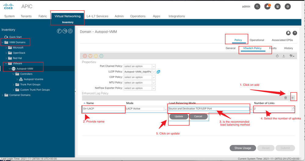

Configure the Enhanced LAG policy:

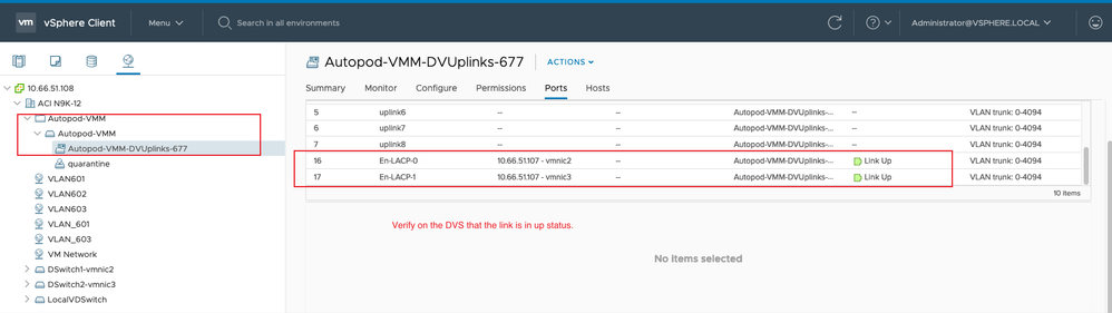

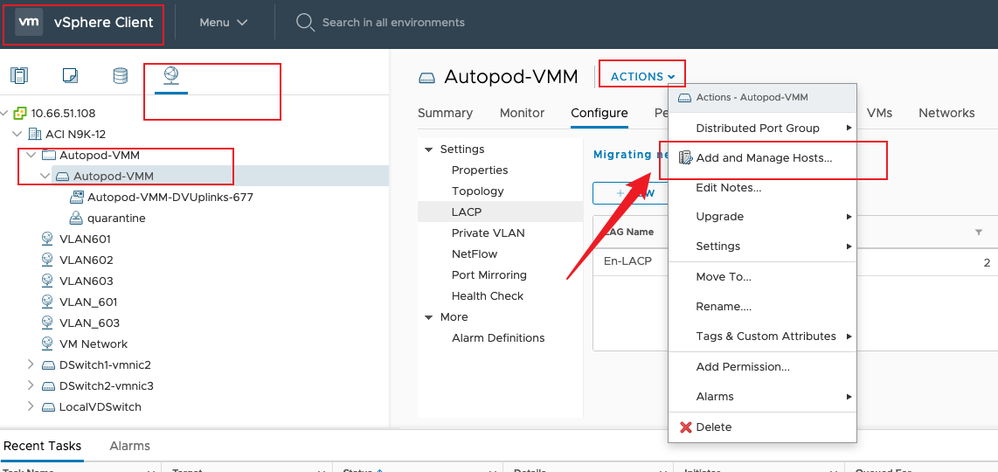

Log in to the vSphere Client and verify that the LAG policy is being pushed on the VDS :
STEP 3:

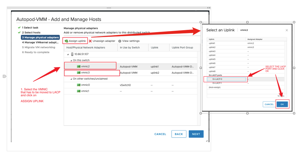

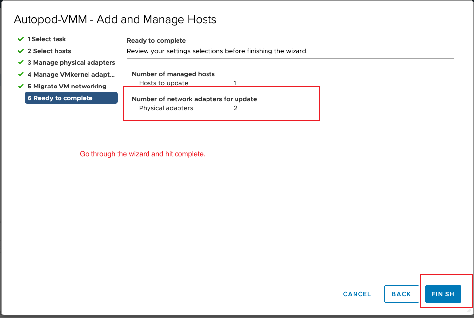

Move the ESXI Host interfaces into the En-LACP policy:
a. Select host
b. Move Uplinks
c. Make sure that the uplink status is connected.
d. Verify on the LEAF switches that the VPC is up.

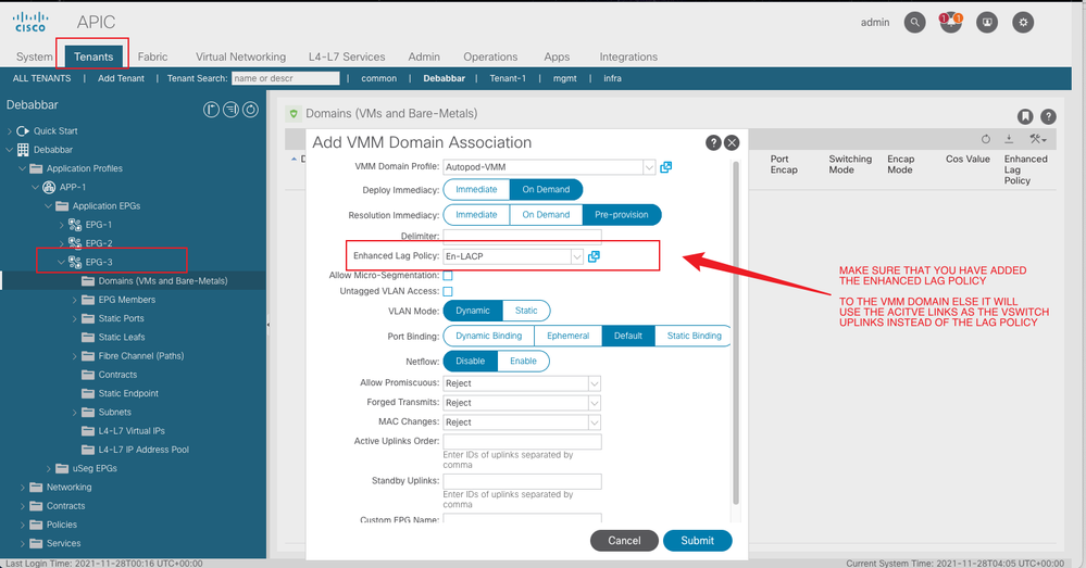

EPG Association with the VMM domain

first I want to say thanks for this information, but I have one question. Are these settings also working for VMM Integration with Cisco UCS Blades / Fabric Interconnect?
I have configured my fabric exactly like this and I'm getting a lot of "ep-mac-is-rogue" errors in my fabric. It seems MACs are flapping between the Uplinks.

Cisco UCS Fabric Interconnects do not support LACP on the southbound ports toward the blade server. Therefore, you can use only  MAC pinning.
you need to change the Port Channel Policy under the VSwitch policy in the VMM Domain to Mac Pinning, that would solve your problem, if your vCenter contains Blade servers and other rack Mount server that are not connected via the Fabric but directly to the Leaves and you still wanna keep the LACP policy you need to create a new VMM Domain policy for the same vCenter. that would also works fine.

That's correct - But with ACI 5.2 you need to configure an Enhanced Lag Policy, otherwise you'll get an error on the ACI fabric.
To get the problem solved I did following configuration:
I Configured an enahnced lag policy vSwitch Policy but I didn't use it. I'm still using direct uplinks in the dVS on VMware side, and I didn't use the anhanced lag policy in the vmm domain configuration for the epg.
