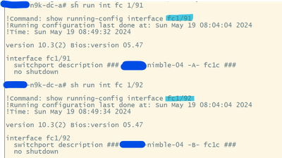

Hi Ron,
please provide "show run int" for specific FC ports.
the provided configuration is for FCoE and not for FC native
robad
Thanks for your reply
Here it is :
advinski
ok, actually nothing is configured
and the other side?
