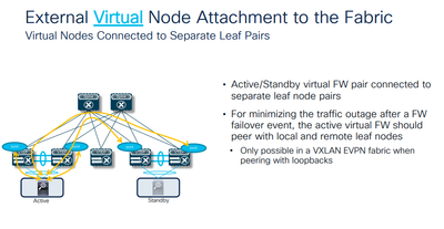

I am working on a design where I need to connect a Palo Alto firewall cluster (A/P mode) to a VXLAN EVPN fabric, with each firewall being connected to a different vPC leaf pair.
The VXLAN EVPN fabric will use anycast gateway, with the firewall providing the L3 VRF-lite handoff. The goal is to use eBGP between the border leafs and the firewall.
I am now trying to decide what the best routing design is for this handoff.
It seems that the recommended approach is to use BGP peering between the firewall and a unique loopback on each VTEP (4), and use static routes on the firewall pointing to the AGW of the subnet to reach the loopbacks, as shown in this Cisco live session:
https://www.ciscolive.com/c/dam/r/ciscolive/emea/docs/2025/pdf/BRKDCN-2974.pdf
Can you get the same result by just using a VLAN which is stretched between the different vPC pairs using a L2VNI? The firewall would then peer using BGP with each of the (unique) SVI IP addresses on the VTEPs. Like this there are no static routes needed.
Any pros and cons for each design?
The Cisco Live session also states "Peering can be established with unique SVI addresses on the leaf nodes only for non-VXLAN VLANs". Not sure what they mean by this or why this would be the case.
