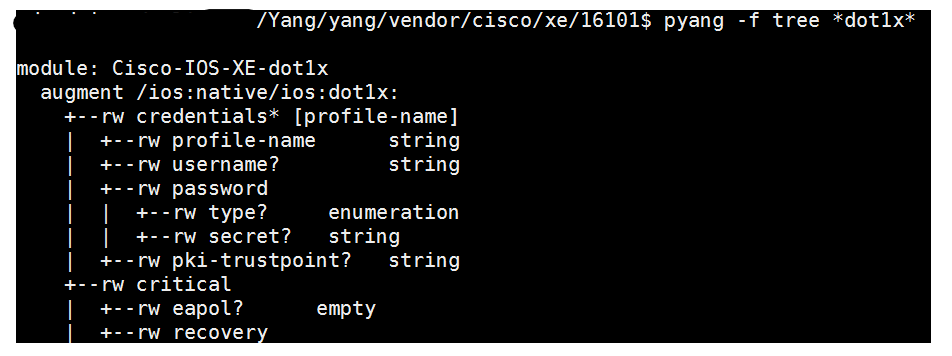

I can form simple Restconf query from simple Yang models like below.
I know 'augment' is for extended data models.
Can someone explain how can I create a restconf query for below data model ?

There is nothing specific you need to do to retrieve details based on the augmentation model. Assuming the device supports the augmentation, when you send a query to the device, you'll retrieve details on the base model and any augmentations that are relevant.

In your question, you're inquiring about a model that augments the Cisco-IOS-XE-native model, so you'd just make a request targeting the path from the Native model.  Something like this:
curl -k   -u 'root:D_Vay!_10&' \
>   https://ios-xe-mgmt.cisco.com:9443/restconf/data/Cisco-IOS-XE-native:native/dot1x
I don't have a device with dot1x configured handy so can't show the sample response, but the request path should be accurate.

Like the name says... this yang model only augments / extends another yang model.
So my assumption is, you're using the incorrect yang model for dot1x queries.
The Cisco-IOS-XE-dot1x module is linked to ios-native. So I would search in the "Cisco-IOS-XE-native" model.
There's a container for dot1x (which is augmented by Cisco-IOS-XE-dot1x)

Thought I would add my reply since this topic didn't answer the question and found out by trial and error...
Reading the original question its asking how do you use the augment to build a restconf query.
Based on this
augment "/ios:native/ios:dot1x"
your restconf query would be
/restconf/data/native/dot1x
