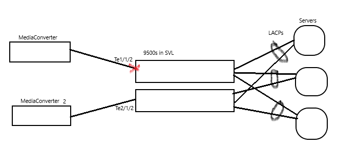

Hi people, My c9500-40X experienced an STP issue with an ISP device twice (on the 29th and on the 5th).
How can STP issue can be seen on a single cable connection towards the ISP device. Could this issue be added by the ISP?
Based on the logs this led the network to go down...
-Can STP issue put VLANs down? Seems to start with Te1/1/2 STP issue.
-Can STP cause LACP connections to go down?
Te1/1/2 has a connection to an ISP device for a P2P circuit, it is configured as a trunk because the port didn't work as an access port on vlan104.
Same ISP provides another P2P circuit connected to Te2/1/2, but this didn't showed up in the logs
The biggest issue apart of LACP issues is loosing OSPF with neighbor.
spanning-tree mode rapid-pvst
spanning-tree loopguard default
spanning-tree portfast default
spanning-tree portfast bpduguard default
spanning-tree vlan 1-1005 priority 24576
interface TenGigabitEthernet1/1/2
switchport trunk native vlan 104
switchport mode trunk
end
interface TenGigabitEthernet2/1/2
switchport trunk native vlan 103
end
Logs below:

you mention LACP and I dont see config, can you more elaborate and also please draw if you can
Hi, LACP connections are setup for servers, not for the ISP device. How an STP issue could tear down VLANs, and also LACP trunks for servers. LACP with servers are trunks too
media converter is lead to where ?
The Media converter Lead to the ISP Network, this is the one receiving the P2P circuit and delivering the handoff to T1/1/2 on our switch.

Hola Jesee
I don't know if the ISP configured STP priority on their side, we don't have access to their configuration.
This is the configuration on the switch:
end
end
Please let me know if you want me to share something else from the switch configuration.
Thanks and regards,

mauricio2099
Unfortunately and sadly the ISP said they didn't see any issue on the link. The good thing is that this has not happened anymore, which if you agree, the issue is not caused by a bad cable between my switch and the ISPs Media converter.
Thanks @Javier Acuña for the punctual anwsers which help to understand the symptoms.
Let me tell you that the LACP logs, were seen because the infra team had to reboot the servers as the communication with storage was lost.
I appreciate everybody's help!
