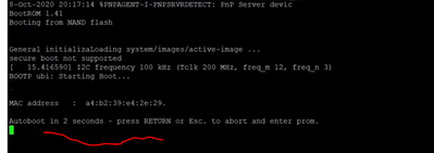

No, we  dont have access to the linux environment as far as I know, maybe Cisco does. When the device is bootinh try to press return and or ESC to try to get to the recovery mode.
If can´t get here,  you may need RMA the device.
Hi Flavio,
The option to press Return or ESC doesn't appear, snif, snif, .....
I will have to apply for an RMA.
