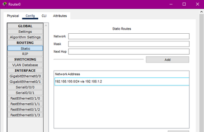

Hello. I have a issue with the static routing. I dont know why it isnt working.I watched many videos to try to solve the problem, I do exactly what videos and posts say. Here is the network, If i send a message from the PC0 to Router0, it is successful but when i send from the PC0 to Router1, it says "failed".

Hello @bautiarcangeli,
Look the second byte:
Then modify interface serial 0/0/0 on Router0 like this:
From Router0, you should ping Router1 interface serial 0/0/0:
Also, on Router1, modify ip route, instead of
configure this:
After that, from PC0 you should be able to ping PC1:
and vice versa.
Best regards

Thank you so much for answering me. Now, it works fine after the changes you said. I have another question, does changing router0 IP to 192.188.1.1 means that it is on the same network as the router1, that its ip is 192.188.1.2? Wouldnt static routing work to connect routers from differents networks? Thank you!!
You're welcome @bautiarcangeli
Interco between R0 and R1 have to be in a same subnet. You should use /30 network, it is sufficient.
Best regards
