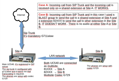

John,
The diagram helps a lot. Cisco phones can speak G.711alaw (and ulaw of course) and also G.729. So it is likely that the Site A phone is using G.711alaw when answering the call even if it is specifically set to use G.729. If the dial-peer connecting Site A and Site B specifies G.729 then, yes, the calls would fail unless there is a transcoder present when calls are answered by a Site B phone. This fits the behavior you have described as well. The debug shows only the conversation between the Site A router and the service provider, so I don't see the negotiation between Site A and the phones nor Site A and Site B. But this fits the facts we do have.
That said, the INVITE from your service provider does show G.729 offered while the 200 OK back to the service provider shows a selection of G.711alaw. How is the dial-peer facing your service provider configured? Does it have a codec declared on the dial peer (codec g711alaw) or does it have a voice class codec configured with a list? Can this altered to prefer G729 without breaking something else in your system?
(For instance, if you are using CUCExpress for voicemail that is G711 only and if you accept PSTN calls with G729 you would need a transcoder for any PSTN calls that roll to voicemail. I don't know if you have any other components that require G711, but those would have to be evaluated for compatibility with G729.)

Hi Maren,
Thanks a lot. let's go in parts.
1.- At the beginning the SIP provider told me that de codec must be G711alaw. Now ( and as you say and as I have seen in the log ) the provider send me a INVITE with G711alaw and G729. Maybe this is my salvation.
2.- The codecs are declare in both ways, voice class and some of them on the dial peer. I kwon that it's not a good idea. Maybe is the moment to fix it.
3.- We don't use either voicemail nor PSTN. Just SIP trunk calls. Then, if I change whole system to use G729, maybe my problems will disappear completely.
Best regards and thanks a lot.
If bandwidth is a big issue, standardizing everything on G729 might be a solution. But if you can support it, you may find things easier if you standardize on G711alaw.
If you do standardize on G729, declaring that on the provider-facing dial-peer and on the intersite dial-peer (or preferring it in the voice class codec) should resolve the problem.
Give it a shot and let me know how it goes!
