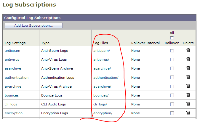

Go to the Gui, look at System, Log Subscriptions, and find the LDAP log...
The "Log Files" column shows you the directory its in, so in FTP you can CD to that dir...
If you CLICK on it, it takes you to the directory where you can click on the file to download it.
If you're using ftp, cd to the directory you specified when you created the log subscription...if you can't find that, go see what folder the gui thinks your files are in...

If only my C170 displayed the Log File column. Is it possible to add it?
Thanks!
I discovered that the Log File column does not appear when the C170 is in a Cluster. (Mine is.)
You have to turn on FTP under System Admin / Network. Then FTP to your C170 using the directory name created in the Log Subscription. Works great! Man, these logs are intense.

The steps to obtain log files:
  1. FTP://your ironport ip address
  2. Click on the Log file type you want to download
  3. Right Click / Save Link As...
  4. Keep default or rename
  5. Open a Spreadsheet app
  6. Open the downloaded file and adjust columns as needed. Fixed width usually works.
