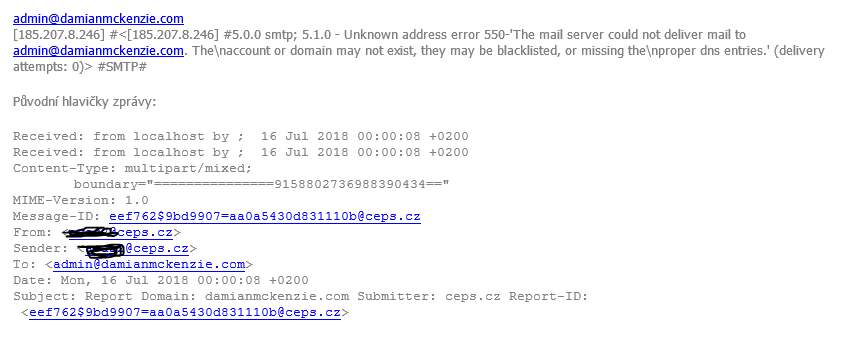

I'll try to describe it again:
1. my ESA create DMARC Aggregate Report and send it according to RUA to some external domain (see. pict 1) Capture5.PNG
2. the RUA recipient doesn't exist and this report is returned back to me: Capture6.PNG
3. I have about 1 hundred such bounced emails from many different domains daily.

To disable sending DMARC reports go to ESA->Mail Policies->Mail Flow Policies->Default Policy Parameters and under DMARC Verification uncheck "Send aggregate feedback reports".
If you have "Trusted" sources you may override this setting for them (enable only for them)
Lemat
Frequent Visitor
Frequent Visitor
Or you may go to System Administration->Return Addresses and set DMARC Feedback to an mail address, which delivers everything to /dev/null
