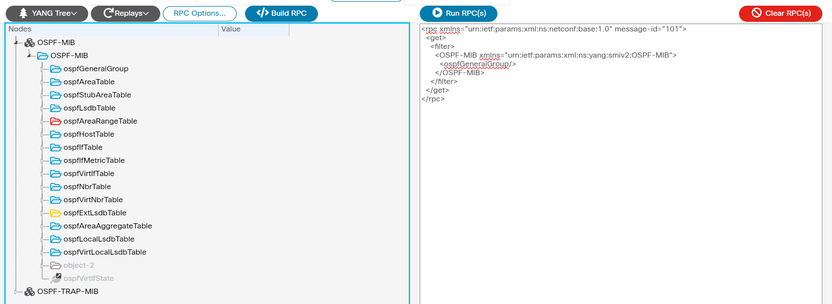

Hello guys,
Recently I've started to work with YANG SUITE NETCONF, but there is one problem.
When I try to load OSPF-MIB, OSPF-TRAP-MIB, CISCO-OSPF-MIB, CISCO-OSPF-TRAP-MIB modules, there is no response from the device. All other modules work properly except MIB modules. SNMP also works properly.
I use ESR6300 IOS-XE 17.12.4 with YANG module 17.12.4 form the github  repository.
Does anybody know the solution to this problem?
Thank you in advance.
@dundient congrats you might have found a bug. Would note this on the issues at https://github.com/CiscoDevNet/yangsuite
Hope this helps.
Please mark this as helpful or solution accepted to help others
Connect with me https://bigevilbeard.github.io
