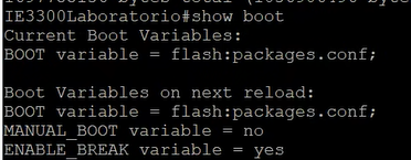

Before erase:
WR ERASE:
After nvram, sdram and flash, have the same files include startup-config in nvram, all same files, nothing changes.
Show boot you dont read "no boot system":

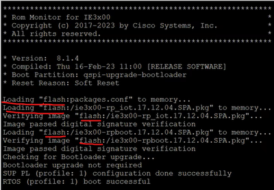

HARD RESET SWITCH.
But the process works and boots from sdflash, loading the new configuration.
Loadind SDFLASH:
Failed to initialize nvram:
Triggering swap drive:
Restarting system by soft Reset (auto process)
Loading flash:
And finish Switch started with SDConfiguration:
