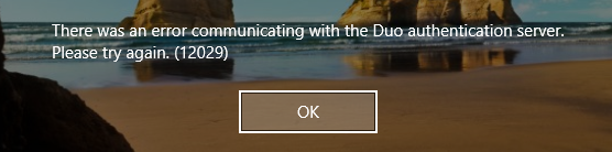

So, I did configure the settings mentioned here [Duo Authentication Windows Logon RDP: FAQ | Duo Security] (Duo Authentication Windows Logon RDP: FAQ | Duo Security), as you suggested. Though when I blocked Ports 80/443 from my edge firewall for member-server, I got an error:
My Duo authproxy server has internet connection, btw.

Correct, [ad_client] is only used when you have also configured a RADIUS or LDAP server listener on the Duo Authentication server (radius_server_* or ldap_server_auto) and have a RADIUS or LDAP application pointing to the Duo Authentication Proxy for primary and secondary authentication.
Duo Authentication for Windows Logon deployments do not require installation of Duo Authentication Proxy on your network at all. But, if your Windows clients do not have direct internet connectivity to Duo’s cloud service and you do not already have an HTTP proxy for these clients to use, you could use Duo Authentication Proxy for this.
So, you are trying to use the Duo Authentication Proxy server on your network as the HTTP proxy for Windows clients with Duo Authentication for Windows Logon and have issues…
  1. You configured the Windows system where Duo for Windows Logon is installed to use your Duo Authentication Proxy server as an HTTP proxy with registry entries, but did you also perform the corresponding config change at the Authentication Proxy (adding an http_proxy section with the IP addresses or subnets of the Windows servers that will proxy the Duo authentication connection through that Authentication Proxy server)? You need to make both changes for the Windows clients to connect through the Authentication proxy server to Duo’s service.
  2. Does your Duo Authentication proxy server have direct internet connectivity or have you configured it to use an outbound web proxy too (with the http_proxy_host and http_proxy_port settings in the [main] section? If the Authentication Proxy is using a web proxy to connect to Duo then it cannot also act as an HTTP proxy to other systems so they can connect to Duo. The Authentication Proxy requires direct outbound connectivity to Duo to act as the HTTP proxy for other hosts.
  3. If you have already checked 1 and 2, try enabling debug logging on the Authentication Proxy server and on the Duo Windows client, perform your test again, and go look at the debug output to see what is happening.

Sorry for not getting back sooner. I’m now getting new error from client machine

Hi - I removed your log output screenshot because it contained some of your customer information in a non-redacted form.
The error message received was: Bad Proxy Request: Attempted connection creation to non approved host: <your duo api hostname> . This suggests that clients were trying to use the Authentication Proxy as an HTTP proxy to connect to a different API host than what was configured on the Duo proxy itself.
  1. Is the api_host value in your [http_proxy] section of your authproxy.cfg the EXACT same API host value used to install Duo for Windows Logon on those Windows clients?
  2. Did you restart the Duo Authentication Proxy service after making changes to authproxy.cfg? A restart is required for changes to take effect.
If you check both of those points and still have issues I suggest you contact Duo Support to open a case.

Hello @DuoKristina - sorry for the late response as I was away. I had another look, and I found the cause for the error. It was my fault - I double added the “api-” so my proxy was trying to reach “api-api-xxxxxx”.
After removing “api-”, it’s now working.
