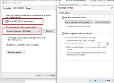

On PC:
1-Service
2- NIC
On Radius_NPS:
-Add the Client
Configure Network Policies with conditions & constraints
The switch part looks very similar to what I have, with exception that I have dot1x pae supplicant, rather than dot1x pae authenticator.  I changed it and it doesn't seem to make a difference.  Right now, if I plug into the port, it will let me on the network whether I have a certificate or not, and I don't see any requests going the the RADIUS.  I do see requests going to the RADIUS, and NPS Server logs if I run "test aaa group NPS_Servers test-user test-password new-code".  The PC and NIC settings look interesting, but in the first instance, I am trying to get it to fail when I plug in with no certificate.  Once that happens, and I see requests being sent to the RADIUS server, then I can enable to PC service.
