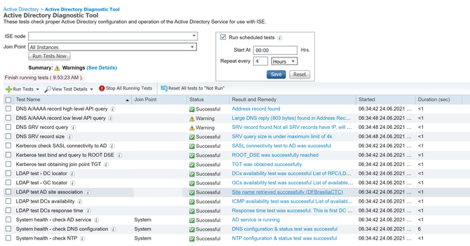

I already run all of nodes. then we got status on all nodes are warning DNS SRV record query.
Please see in the attached file for more detail.
Please help to advise on this. Thank you so much.
Hi @sinady ,
 check the following:
ise/admin# nslookup <Node IP Addr> querytype AAAA
Trying "<Node Reverse IP Addr>.in-addr.arpa"
;; ->>HEADER<<- opcode: QUERY, status: NOERROR, id: 41346
;; flags: qr aa rd ra; QUERY: 1, ANSWER: 1, AUTHORITY: 0, ADDITIONAL: 0
;; QUESTION SECTION:
;<Node Reverse IP Addr>.in-addr.arpa. IN PTR
;; ANSWER SECTION:
<Node Reverse IP Addr>.in-addr.arpa. 14400 IN PTR <Node FQDN>
Received 80 bytes from <DNS IP Addr>#53 in 1 ms
Hope this helps !!!
