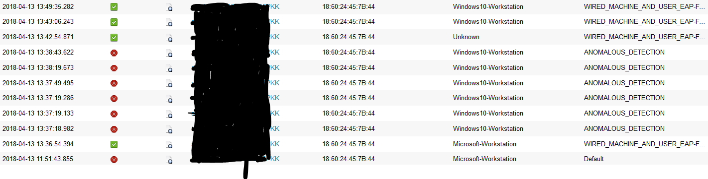

I have a few deployments where I am using EAP-FAST with chaining via the NAM module and noticing users that are moving from wireless to wired or visa versa are triggering Anomalous Behavior.  I believe this is due to the NAS port type change but I am trying to understand why that would be a criteria since the endpoint MAC would be different between those connections.  Any help would be appreciated.

  1. NAS-Port-Type - Determines if the access method of this endpoint has changed. For example, if the same MAC address that connected via Wired Dot1x is used for Wireless Dot1x and visa-versa.
  2. DHCP Class ID - Determines whether the type of client/vendor of endpoint has changed. This only applies when DHCP class ID attribute is populated with a certain value and is then changed to another value. If an endpoint is configured with a static IP, the DHCP class ID attribute will not be populated on ISE. Later on, if another device spoofs the MAC address and uses DHCP, the Class ID will change from an empty value to a specific string. This will not trigger Anomouls Behaviour detection.
  3. Endpoint Policy - A change in endpoint profile from Printer or IP phone to Workstation.
So looks like you are hitting the 1st case
Nidhi,
Actually it appears to be the 3rd case but it seems drastic to say that a change from "Microsoft-Workstation" to the more accurate " Windows10-Workstation" would be a trigger.
Has anyone else seen similar behavior?
