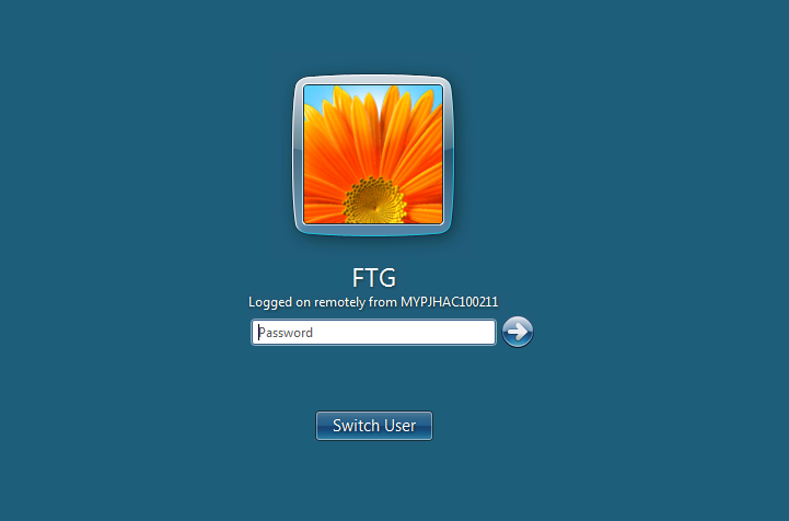

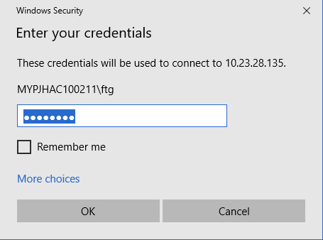

Hi, please find attached file for both login screen.

First login
Second login
