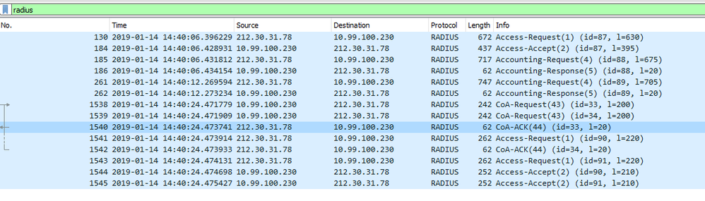

Can you take capture from ISE to ASA/ ASA to ISE and check whether coa-request is send & received by the ISE in the radius packet?

This is exactly what I did earlier. Capture from ISE to ASA shows ISE sending the CoA to the ASA. Capture on ASA does not show the CoA request that ISE sent.
Tweaking the NAT statements on the firewall in from of the ISE server to be a static one-to-one NAT fixed the issue. I believe the issue was caused by asymmetry.
