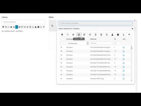

And the policy looks like this:
When the user connects via SSL VPN, take a look at the Calling Station ID attribute that comes to ISE with the access request. That is the closest you’ll get to a MAC address.
