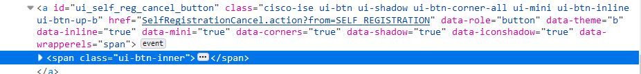

The example you gave works well on a standard Self Registered Portal Page!  But on my customised Portal Builder imported portal it doesn't work at all.  I already have two other pieces of JQuery running that hide the Login page (and jump to Self Registration automatically), and then finally on the success page I am hiding all the stuff I don't want the user to see.  That all works.  But I am unable to hide the Cancel button to finish off the job!  When I inspect the code I see differences in how PB constructs the page, versus how the vanilla ISE deployment builds the page.  In standard ISE deployment you can use the #ui_self_reg_cancel_button property
In Portal Builder code, there is no such property.  Perhaps that is the underlying reason
Below is the Cancel button (inspected) as built by Portal Builder
Now the question is:  does this object have methods like .hide() or somesuch?  This is where having an understanding of these frameworks would be useful, instead of me guessing my way around.  If anyone has a clue please let me know.

Through the power of Cisco and the Community, I got the answer I needed.  It now works.
How the engineer came to this conclusion is still a mystery to me, but it has something to do with "finding the respective object in the DOM" - I think DOM is Document Object Model.
<script>
     jQuery(function(){
       jQuery('.t-button_cancel').css('display','none');
       return;
</script>
