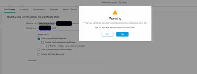

Ok i did it . Whne i tritd to add the bind i recived an error . But now.
I am using a certificate with the .crt extension.
When I added it to the trusted certificates, I received this warning
Dustin Anderson
ok, the first error is expected as when you reassign the portals they restart to apply the cert. This is not a system restart so not disruptive. I have not seen the second error, but question is when you got the cert, did you get just the cert, or is it the cert with chain? I usually load the cert with chain.
