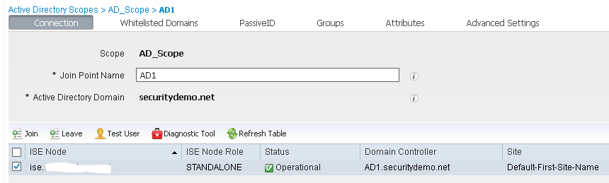

Attached is from our ISE training lab.
Joint Point Name: demoAD -- this can be anything as long as it unique in ISE system dictionaries and in supported character set.
Active Directory Domain: demo.local -- this is the AD domain name. In your case, it should be factorytest.com. Please ensure the DNS servers configured for ISE able to resolve all AD DNS records efficiently.
Domain Controller: ad.demo.local -- this is the DC that ISE connected to.

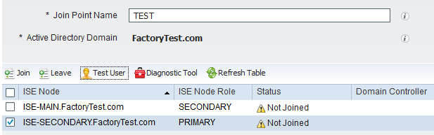

Yes I have tried with above suggestion however could get same result.
Please refer screenshot for your details understanding.

Are you getting errors while joining the ISE nodes to your AD domain? I am not seeing a screenshot on that.
As Charles said, the ISE nodes need joined to the AD domain before such tests to work.
Charlie Moreton
You have to join the domain with ISE.  Go back to where you added the AD Server, select that server and click the Join button.  You will be prompted for credentials.  These credentials need permission to join machines to the domain.
