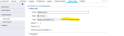

08-12-2024 08:51 PM - edited 08-12-2024 08:59 PM
Just out of curiosity, could you please check the email addresses listed in your alarm email? Then, verify them with the Cisco ISE admin accounts under **Administration > System Admin Access > Administrators > Admin Users** to see if there is a corresponding account with those email addresses.
If you find a match, verify whether the "Include system alarms in mails" option is enabled for that account. Try disabling that checkbox and observe whether the alarms continue to be sent.
Let me know if that helped you !
Regards,
Rakesh

04-28-2025 11:53 AM
Yeah this fixed my issue too.

08-12-2024 11:53 PM
This was exactly it. After removing the checkbox, mails stopped coming into the mailbox i wasn't expecting them. I had no clue about that.
Thanks a ton Rakesh!
