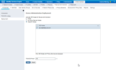

Enable Device Admin Services on Cisco ISE.
Go to Administration>System>Deployment>Ise(If it is in standalone)>Enable Device Admin Service.
This will enable the Device Admin Service on Cisco ISE.
Alternatively, you can enable Device Admin Service by going to
Work Centers>Device Administration>Deployment
You can click on All policy service nodes or you can select nodes by specifying the nodes.

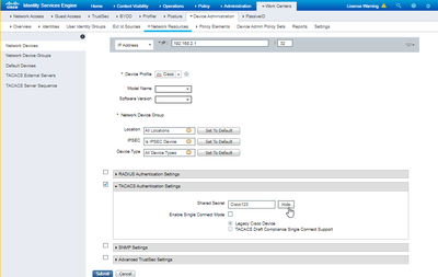

Adding Network Devices on Cisco ISE
Go to Work Centers>Device Administration>Network Resources>Network Devices>Add
Fill in the required details of your target network device that you want to add and tick on TACACS Authentication settings.
Remember the Shared Secret key as it would be used to add on the router while configuring AAA.
Click Submit.

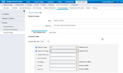

Create a TACACS Profile for assigning privilege levels to the Users.
Navigate to Work Centers>Device Administration>Policy Elements>Results>TACACS Profiles>ADD.
Add the default and maximum privilege level that you want for the users and click submit.
As it is full access I will keep it as 15 so the user will directly start with privilege exec mode(#)
For Read-only users I will keep the default privilege level to 1 and the Maximum privilege levels to 15 so that they will start with User exec mode (>) and then go to privilege exec mode (#) after entering the enable password but they will be limited to only show commands.

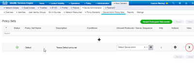

After creating the TACACS profile and command set, it is now time to create a Device Admin Policy Set by merging the TACACS profile and command set.
Navigate to Work Centers>Device Administration>Device Admin Policy Sets
Here I am keeping the Default policy set.
Now click on the View(>) Sign on the far right.

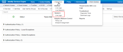

To check for logs on ISE Operations>TACACS Live Logs
For users with read-only access:
Command authorization failed as I have not allowed this command in the command sets for read-only users.
