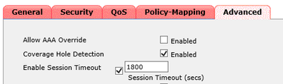

I have ISE 3.1 with patch4 installed. I implement Guest Portal access for guests who visiting our company. Guest Portal is manage by Sponsors - They must create password and give it to Guest, then Guest has access to network (only Internet). Everythink working good but after 10 minute Guest report me that connection is termination. This situation happen always, after 10 min guest is logout out from guest network... I don't see any configuration with set time to 10min...
Any idea ? Where is problem ?
mikiNet
Ok, I have a solution. I disable this option on WLC:
Uncheck "Enable Session Timeout" - then all works good.

also check session timeout in WLAN Advanced config, anything changed :
Glad you able to fix the issue, that was my suggestion before.
